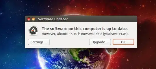

I could just do it via usb but why the hassle if you don't have too, any reason why it wouldn't just be offering the update?

You can always upate through terminal to the latest version:
You'll first need to make sure update-manager-core is present (it may already be installed):
sudo apt-get install update-manager-core
Next, run:
sudo do-release-upgrade
You may need to check /etc/update-manager/release-upgrades and change the line:
Prompt=lts
to:
Prompt=normal
for the release to show up.
