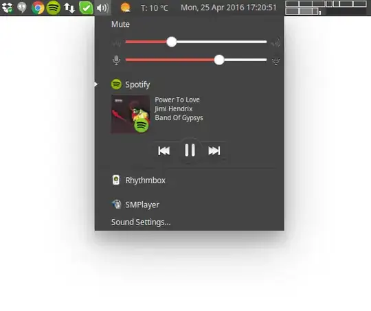

The shadows that remain look like this: Shadows on indicator plugin
They also appear on the Skype and networking context menus, but not on any of the others, including the calendar and user switcher.

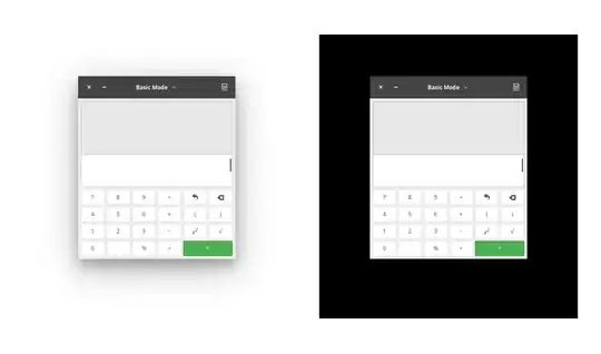

In addition to the panel, I'm also getting a shadow on the calculator application, but not on any others that I have tested…
Are these being rendered by compton, or is there something else going on here? If I kill compton, those shadows are replaced with a big block of black, as seen here on the calculator, but this also happens with the indicators in my panel, too:
With and without compton running
