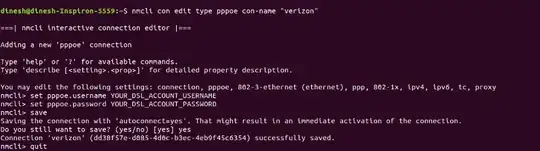

This tutorial is going to show you how to setup a PPPoE connection in Ubuntu from the terminal.
  1. Open up your terminal and type the following command to set your PPPoE connection.
    nmcli con edit type pppoe con-name “YOUR_CONNECTION_NAME”
  2. Enter your DSL account and password provided by your ISP and save your settings in the following commands.
    set pppoe.username YOUR_DSL_ACCOUNT_USERNAME
    set pppoe.password YOUR_DSL_ACCOUNT_PASSWORD
    save
    Then it will prompt asking:
    Saving the connection with ‘autoconnect=yes’. That might result in immediate activation of the connection.
    Do you still want to save? (yes/no).
    Type yes and quit.
    Setting DSL connection in terminal
  3. Finally, select DSL connection from the network settings menu to establish the connection.
