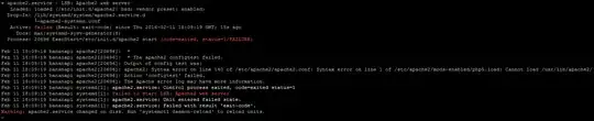

It may be something to do with these errors I get when trying to run Apache2 from the command line.
After running systemctl daemon-reload'

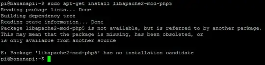

Oh, and I get this error when trying to install PHP5, if this helps.
When trying to install PHP5

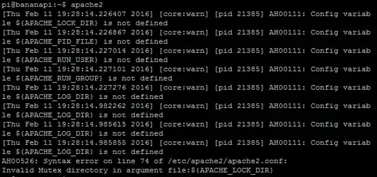

EDIT: Here's the output from running 'apache2' from the command line:
'apache2' command line output
