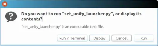

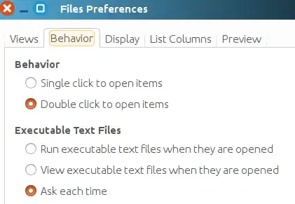

  2. You need to open file manager , go to Edit -> Preferences -> Behavior, and select what to do with executable files

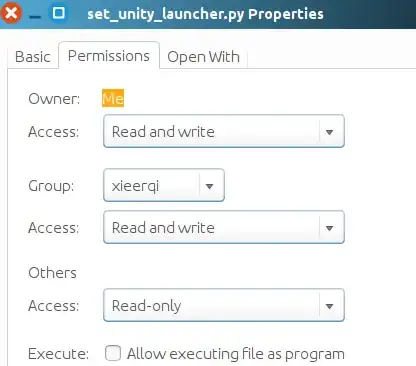

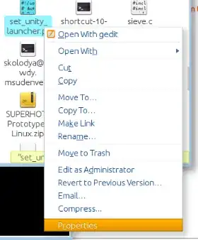

    1. Finally , make sure your file itself actually has executable permissions set. In terminal you can do chmod +x /path/to/script.py and in GUI, right click on the file and alter its Properties -> Permissions

If your script prints output to console, it will need to have terminal window, or alternatively use GUI dialogs such as zenity. Prefer using Run in Terminal option if you want to see the code. If you want the script to do something without seeing console output - use Run option.
In addition, if you have command line parameters , such as sys.argv[1] in the script , you can't set them unless you have terminal window open.
