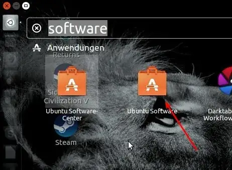

If you have upgraded you should defacto have both software centres (see picture - the one on which the arrow points is what you want)
