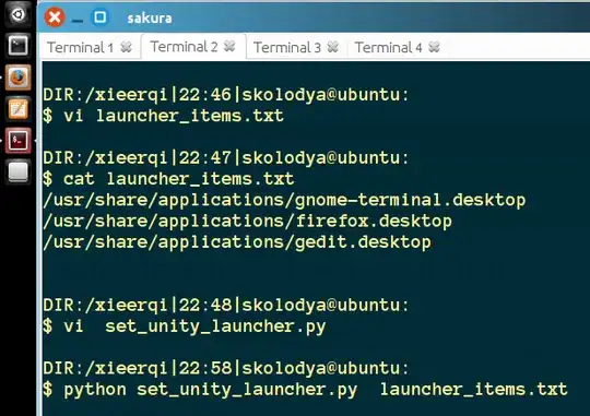

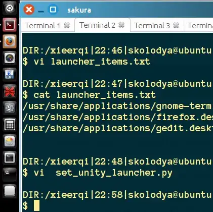

Demo
Before running the script
After running the script
Note that the order is exactly the same as the entries appear in the input file
