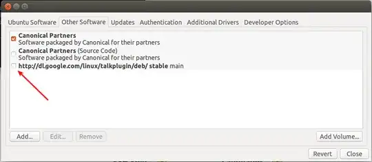

For now, I've disabled that repository by un-checking this:
The above step is my weak workaround for this bug: https://bugs.launchpad.net/ubuntu/+source/apt/+bug/1562733
Someone told me that I could just ignore that error until the repository is fixed (instead of disabling it, like above). However, I did not find this to be the case; it seems that if there is one failure during a sudo apt-get update, succeeding repositories (after that error -- ones without issues) do not get hit (therefore it ultimately blocks your ability to fully update your computer).
If I understand the bug correctly, it seems like Google will need to fix their repository to adhere to Debian/Ubuntu's (new) higher security requirements for signing packages.
