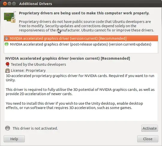

I solved this problem a few minutes ago on my system. For me it worked in the following way:
  1. Installed the post-release nvidia-driver. enter image description here

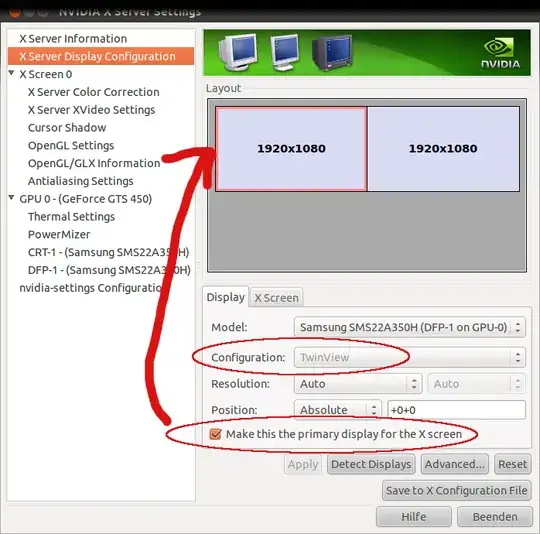

  2. Start the nvidia-settings to configure my dual-screen, there you have to use the TwinView (not the seperate X-Config) and don't forget to choose a primary monitor. The problem I encountered during the config was, that I it only seems to work if I choose the left monitor as primary. To Test you can use the Apply-Button. enter image description here If everything works you can save to X Configuration File.
Here my resulting xorg.conf if you want to read it:
