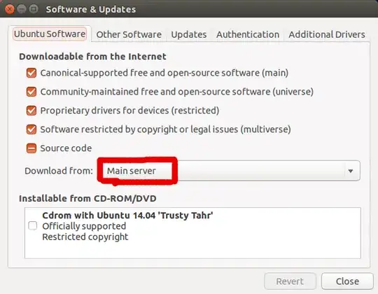

It's probably just a matter of time....if you can't wait try this:
In Software & Updates choose Download from: "Main server"
Then open the terminal and run
sudo apt update
sudo update-manager -d

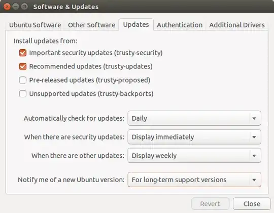

EDIT: also check this tab (in Software & Update)
