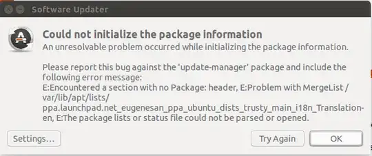

While I update my device using software updater, I am getting following screen and then the updater paused in following screen:

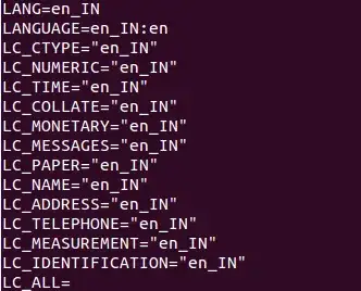

Here is my locale lists, i.e. list which will display after execute locale command:

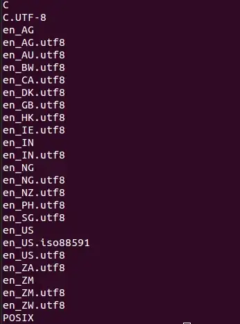

Here is a output of locale -a

After applying changes suggested in answer I am getting following error with my update-manager:
Any help would be appreciated! Thanks in advance.
Looks like the UTF-8 locale en_IN has not been generated on your system. So then generate it:
sudo locale-gen en_IN
Edit:
The error messages reveal a bug in Software Updater. A workaround to get rid of the error messages is to change LANG to "en_IN.UTF-8".
sudo update-locale LANG=en_IN.UTF-8

To fix the new problem, try these commands:
sudo rm -f /var/lib/apt/lists/*
sudo apt-get update
