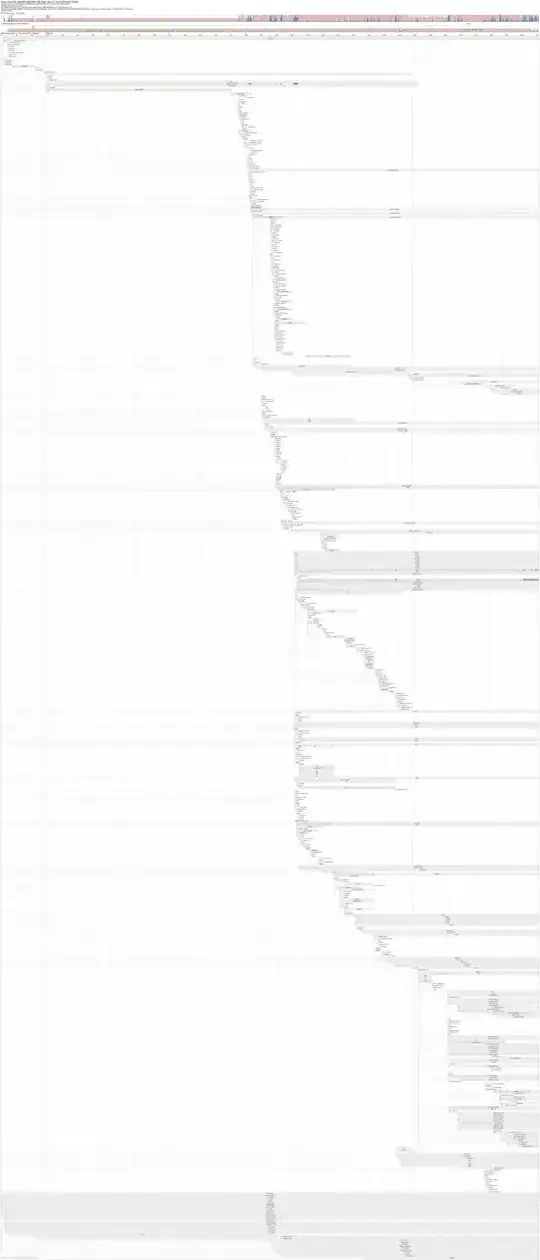

EDIT: Here is the second bootchart image:
HIGH RES
EDIT: This is the bootchart with the ureadahead pack file removed:
HIGH RES with pack file removed

For slow booting problems. You can install bootchart
sudo apt-get install bootchart
reboot your system and analyse chart which should be placed in /var/log/bootchart. It should tell you what causes slow boot. After all you can disable bootchart service with:
