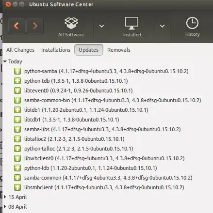

After initially entering the login credentials and selecting "Remember forever" I had always (over 2 years) been able to access the drives by going to "Browse Network" in nautilus and clicking on the Router's Icon then clicking the folder I want to access. Today I had a security update which contained the following:
