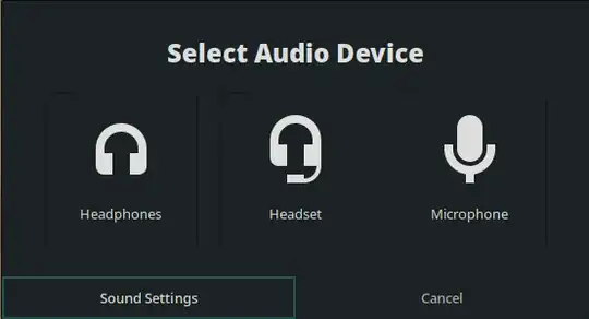

  3. Add the following lines:
# Fix External microphone connected via combo jack on Ubuntu 16.04+ (video)
options snd-hda-intel model=dell-headset-multi
options snd-hda-intel position fix=1
I've tested it on Linux Mint 19.1 and Manjaro 5.6.8-1. On Manjaro, that is the window that pops up when I plug an external mic: External input selector
