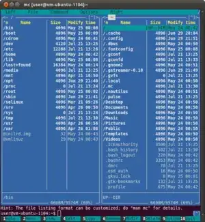

If you are looking for a solution which gives you the benefits of the command-line operations with the GUI feeling and flexibility combined, I recommend mc (midnight commander).
mc commander 2-pane view
It is a ncurses-based visual file manager - you have a two-pane view on your files and a menu available. Use of the mouse is possible, even over ssh. You can browse around your fs, inspect files with the file viewer, filter according to criteria on-the-fly and have the copy or move operations done on the command line.
It's a clone of the DOS program Norton commander which was popular in the mid-Eighties. It works well whenever the GUI starts to get unreliable for me, and ideal for your purpose.
