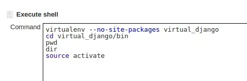

I have installed Jenkins on ubuntu 15.10. In a shell build step I am trying to create a Python virtual environment and activate it: enter image description here
But I get the following error when I run the job:
/tmp/hudson4515625893361069094.sh: 9: /tmp/hudson4515625893361069094.sh: source: not found

So the virtual environment was created successfully but it cannot be activated because the source command cannot be found.
I did verify that I can indeed run the source activate command from a terminal on the machine as the jenkins user in the corresponding workspace:
jenkins@vmi63860 ~/workspace/django-demo/virtual_django/bin ((HEAD detached at 290c6a4)) $ source activate
(virtual_django)jenkins@vmi63860 ~/workspace/django-demo/virtual_django/bin ((HEAD detached at 290c6a4)) $ exit
So why does it fail when I run it under the Jenkins job?

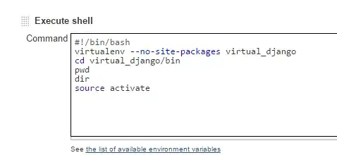

Found a similar post here:
https://stackoverflow.com/questions/670191/getting-a-source-not-found-error-when-using-source-in-a-bash-script
The solution is to add:
#!/bin/bash
in the first line of the script step:

source is a bash/ksh/etc extension, provided as a more "substantial" synonym for .
Try using below
. activate
