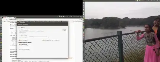

  • Enable workspaces enter image description here

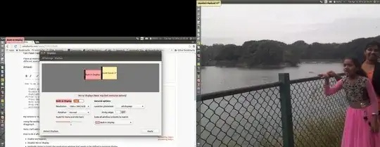

  • Disable mirror display enter image description here

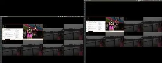

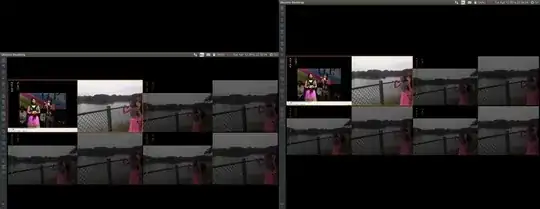

  • Press Super + S enter image description here
  • Both screens are displayed in default workspace
  • Drag the application window to 2nd (right-side) screen - leave the remaining 3 workspaces untouched enter image description here

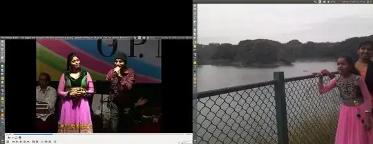

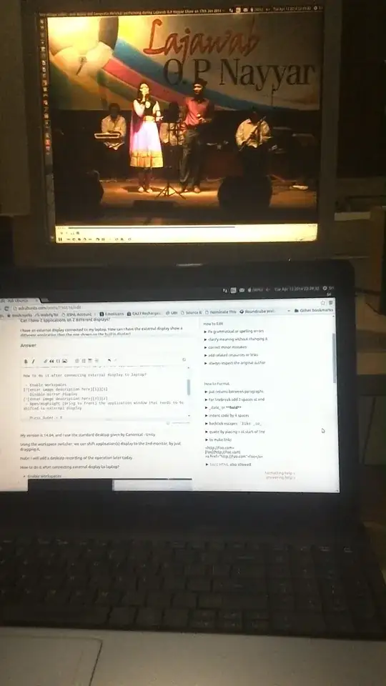

  • Click anywhere on builtin screen. Now the shifted application is seen in external display enter image description here
  • To switch mouse activity/focus to external screen, move the pointer beyond the right edge of screen, to bring it back to builtin screen move the pointer beyond the left edge.
