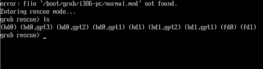

I fresh installed Ubuntu 14.04 on the first one I will say, but after the successful installation (which I assume it has repartitioned my hard drives) when it reboots I get this error:
error: file '/grub/i386-pc/normal.mod' not found

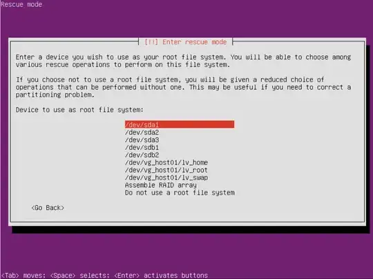

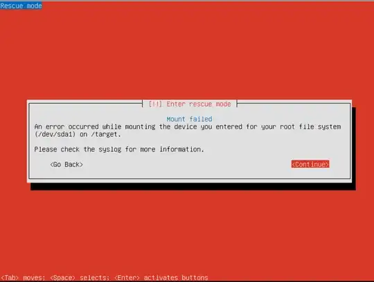

I tried to use rescue mode to fix what the issue is and am brought to a screen that asks to choose the boot device I want, and when I choose /dev/sda1 it says I can't use it.
How do I fix this and/or how can I wipe out everything on my 2 hard drives first, before starting another fresh install?

I just used gparted from http://gparted.org/ and deleted all the partitions
there was the second drive that was locked because it uses lvm2 So i used lvscan to check all the volumes on it and then used lvremove to remove all the volumes, then i was able to delete it as well, before using lvremove the partition was locked and i could not delete
So have 2 fresh hard drives back again
