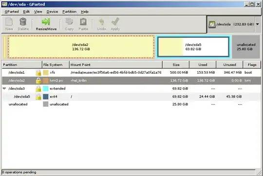

But I cannot find this in df output or gparted:

Why does my swap partition not show up?

I see you are using LVM partitions.
df command never shows swap partitions because they are not a file system partition. You can check your existing Logical Volumes with lvs command and check your device mapper (dm-X) devices witch ls -l /dev/mapper/ or dmsetup ls
