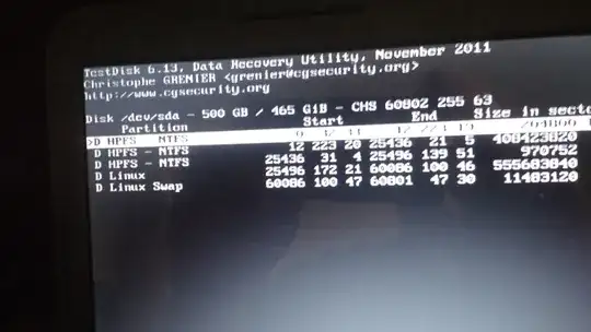

Doing a "quick search" shows 5 deleted items:
D HPFS - NTFS
D HPFS - NTFS
D HPFS - NTFS
D Linux
D Linux Swap
The fourth item down says "Linux" now, but did not say that until I pressed "enter" to continue, and had to put something there to get out of that next screen. It may have said "unallocated" or or been blank.
It appears to me that the data is all there, but I am not certain how to proceed.
It appears to me that...that is showing the deleted files/partitions from Windows 7 & Ubuntu.
I'd like to recover my Ubuntu partition, but it appears that the partitions no longer match up to the current partitions.

Thanks, oldfred. Testdisk ended up working.
In a nutshell, I looked at my deleted files (see image in OP) and changed the types for the Linux items marked "D" to "P" for both. Then, selected "write". (Thinking that would ADD those to the other partitions.)
After restarting, the computer said "grub rescue", same as when I was doing the Windows 10 installation. Installed the Boot-Repair-Disk, and it reinstalled my grub2 menu and recognized my Ubuntu partition, but no Windows to boot into.
Went back in with testdisk and changed the types on all of the deleted partitions, except Linux swap. The top one got an "*", the next 3 got a "P" and the Linux Swap kept the "D" (because of the rule that only 4 partitions can be marked as primary).
My thought was that the 3 top deleted items, must be my Windows 7 partitions and I'll take Windows 7 back over losing my Ubuntu partition.
Did a restart, inserted the Boot-Repair-Disk, ran "recommended repair", did a restart, and my grub was up and running with both Ubuntu and Windows, but it was Windows 10, instead of 7.
So, it all seems to be working again, but with an upgraded Windows.
