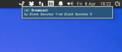

I installed i3 alongside unity but now I see the i3 notification box while on unity.
How can I change this back to the unity one without removing i3? The other solutions to this problem seem to be removing the other WM/DE
