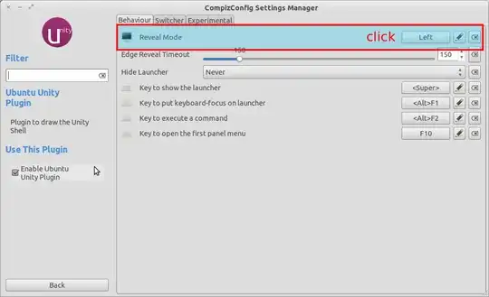

  • Click on reveal mode for the launcher:
    unity config
  • Change the reveal mode for the launcher from left, to the top left corner.
    reveal mode
  • As mentioned in doug's comment, you need to lower the reveal time out to get this to work correctly. It is a bit tricky, but it works.

To just fill out the main answer - There are 2 additional possibilities for 11.10 & likely 12.04
  • Instead of the topleft corner one could choose the bottomleft instead. If you can get used to it seems a less likely spot for inadvertent reveals.
  • The other is to just raise the edge reveal timeout as seen in the screenshot. The max of 1 sec. is actually a long time in terms of mouse movement, I'd try 5-600 or so, probably more than enough.
