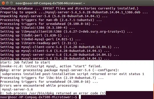

I am getting an E: Sub-process /usr/bin/dpkg returned an error code (1) error when installing mysql 5.6 in Ubuntu 14.04.
I have tried to modified
/var/lib/dpkg/info/mysql-server-5.6.postinst and comment out line 95:
/usr/share/mysql-common/configure-symlinks install mysql "$mysql_cfgdir/mysql.cnf"
but i did not find the
/usr/share/mysql-common/configure-symlinks install mysql "$mysql_cfgdir/mysql.cnf" line
Reinstall it using the cmd on terminal sudo apt-get purge mysql-server-5.6 then sudo apt-get install mysql-server-5.6
