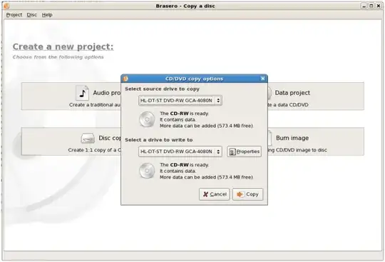

Brasero
alt text
Brasero is a simple application to burn, copy and erase CD and DVD media: audio, video or data. To install Brasero in all currently supported versions of Ubuntu open the terminal and type:
sudo apt install brasero
Brasero is installed by default with Ubuntu. It has a simple interface, but powerful features.
