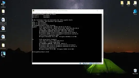

The following screen capture tells an interesting story.
Ubuntu default /etc/hosts file and ifconfig output
Effectively, it shows that 127.0.0.1 is the true loopback address. Thus, 127.0.1.1 is there for reasons other than that of basic IP networking.
As mentioned by @Videonauth, the 127.0.1.1 line is there as a crutch, a fix, to make finicky software be happy.
In my view, the loopback entry should almost always be in /etc/hosts. If you change your hostname from the default of localhost, then change the host name on the 127.0.1.1 line, not the 127.0.0.1 line.
If you change your hostname and give your machine a static IP, change both the hostname and IP fields in the 127.0.1.1 line.
In short, leave the 127.0.0.1 record alone.
