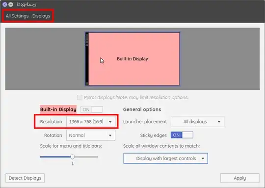

#2: Get your desktop display resolution
We need to know the resolution of our display so as to know which wallpaper size to download.
  1. Launch system settings and select Display
  2. Note your screen resolution somewhere. Mine is 1366x768.

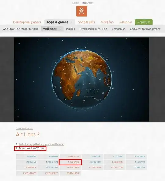

#3: Download Wallpaper Clocks
To download Wallpaper Clocks:
  1. Go to Vlad Studio and click on a wallpaper clock of your choice.
  2. Let us choose Airlines 2
  1. Download the .wcz file using the resolution size of your display as noted above. Mine was 1366x768.
  1. Save it in your computer.

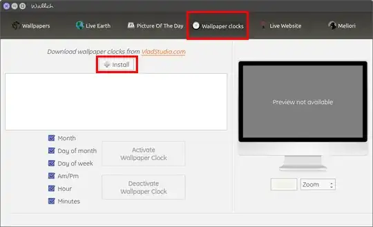

  1. Launch wallch.
  2. Select the Wallpaper Clocks tab and click the Install button.

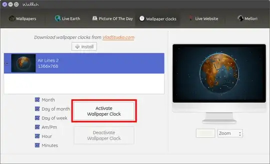

  1. Browse to your .wcz file and select it. Then click on the Activate Wallpaper Clock button. Do not extract it, just open it as it is.
  1. It will be set automatically as your desktop background, with the correct time and date.

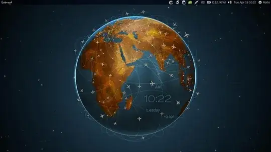

Here's my desktop.
