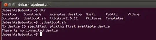

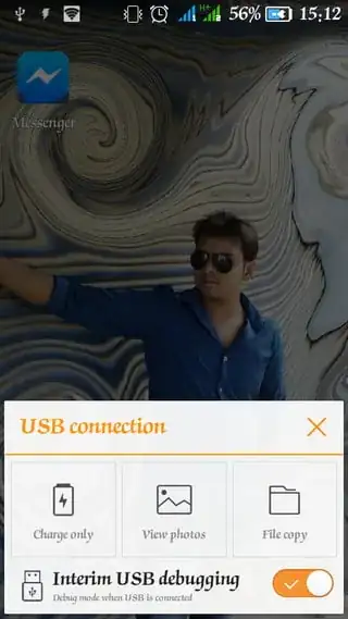

I have A Gionee M2 device which is rooted and Usb debugging enabled.I have installed adb and fast boot on Ubuntu 13.04 and downloaded the "dualboot.sh" file from: http://humpolec.ubuntu.com/latest/dualboot.sh I have also created 51 android rules file and added my device ID but its not detecting my device though its listed under "lsusb"

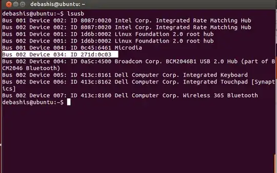

  • This Is My Device listed:
    This Is My Device listed enter image description here enter image description here

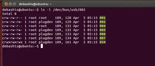

  • The cable is not charge-only:
    The cable is not Chargeonly...

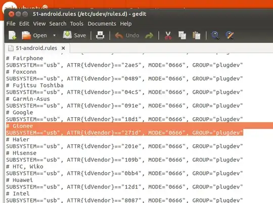

  • I added my device id to the 51 Android.rules file

This may not be the only problem, but you will most likely need to update to version 1.0.32 to succeed. See this question.
