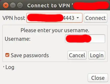

I installed the network-manager-openconnect package and uses it to login to my Openconnect VPN server. The connection works, except that every time I start the connection a two step dialog box pops up and asks for my VPN username and password:
This is the first dialog which asks for the username. If the username is correct, it'll go to the second dialog and ask for the password.
Is there a way to provide the VPN username and password in a configuration file so that it doesn't ask for it every time? This is important since I'm trying to make this machine headless.
