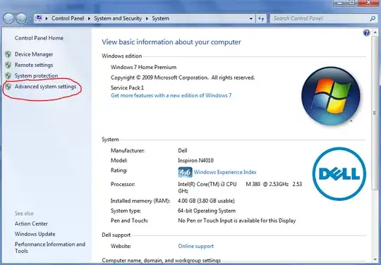

For Windows 7, right click on Computer, Properties, Advanced system settings (on the left):

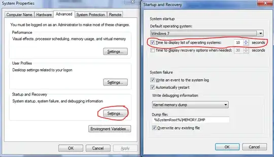

Then click on Startup & Recovery settings:
Make sure the Time to display list of operations systems is set to 10 or above. If that's not the problem, run CMD.EXE selecting to Run as an administrator, then enter bcdedit to make sure there is an entry for Ubuntu.
