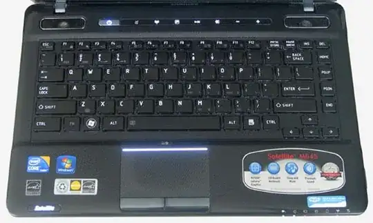

henryr
I have a M645 and the second button to the right of the power button that will toggle the rfkill hard block
Toshiba M645 keyboard
This switch works in 3.13,3.16, 3.19, and 4.2
It seems to be broken in 4.4 but it works now in 4.4.0-38
