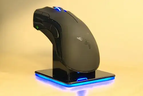

Turns out this problem was caused by a hardware fault in both mice. I fixed it by opening up my mouse and hosing down both the wheel and all the button swictes with compressed contact cleaner.
Unfortunately this dissolved the grease on the mousewheel rigging so I had to apply fresh silicone grease to these parts.
All in all, an £8 spend to bring a £100 mouse back to life seems like a fair deal. Yes, I paid too much for a mouse but it looks pretty.
