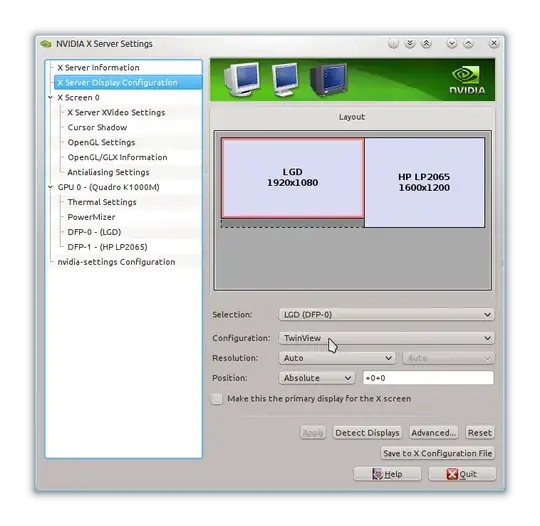

What VGA do you use? If Nvidia, nvidia has own video configuration called nvidia-settings.
screenshot
Pablo Bianchi
  • 17,371
squallbayu
  • 3,054
One thing you can do is unhook one monitor, restart your computer, and then redetect the displays. That should get it (that's what I've had to do in the past, at least).
What about GRandR (git)?
Go in the Software Center and search for "grandr", install it and try it. Not available anymore on Ubuntu 16.04+.
Also you have ARandR, Another XRandR GUI and grandr-applet (not related).
