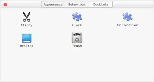

I'm using Ubuntu 16.0.4 with Plank version 0.11.3, and it already has this feature.
  1. Right click Plank on the desktop
  2. Choose preferences
  3. Click Docklets then double click Trash
Screenshot of plank preferences
Screenshot of the final effect in plank
