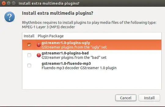

To play mp3 files with Rhythmbox you need the gstreamer 'ugly' plugins. There are 3 good choices to getting these installed and running with Rhythmbox;
1. This should be shown when you try to open such a file:
Simply install from here and Rhythmbox will happily play your mp3s.
2. If the menu does not appear you can install install from the commandline (on Trusty Tahr):
sudo apt-get install gstreamer1.0-plugins-ugly
And hopefully this will be enough to get your mp3s playing.

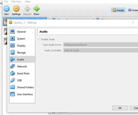

I tried the stated solutions but nothing worked. What worked was when I went into the virtual box settings under Audio and started going between the different settings.
Once I did this, and probably in combination of the other stated solutions in which you do in Ubuntu itself, I was finally able to listen to and play my MP3 files.
