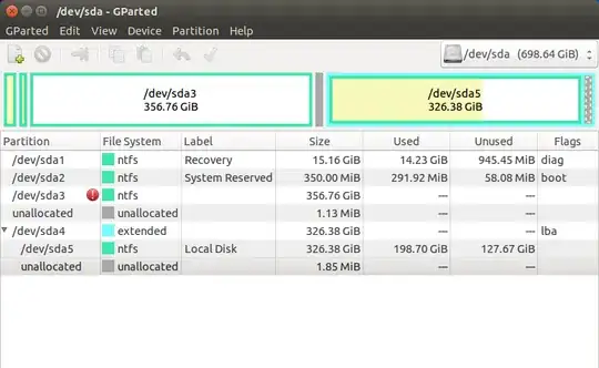

sudo fdisk -l
Device Boot Start End Sectors Size Id Type
/dev/sda1 2048 31791103 31789056 15.2G 27 Hidden NTFS WinRE
/dev/sda2 * 31791104 32507903 716800 350M 7 HPFS/NTFS/exFAT
/dev/sda3 32507904 780682991 748175088 356.8G 7 HPFS/NTFS/exFAT
/dev/sda4 780685310 1465147391 684462082 326.4G f W95 Ext'd (LBA)
/dev/sda5 780685312 1465143607 684458296 326.4G 7 HPFS/NTFS/exFAT
I don't have any linux partition, should I install linux? Is there anyway to fix this?
