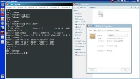

The trick is . . . hidden dot files( the ones that have leading dot in the name, e.g. .file1.txt ). They are included in the total count of files and folder size , but are not shown by default. Observe the example bellow: I've a folder /home/xieerqi/EXAMPLE where I copied contents of my /etc/passwd file. In the properties you can see total count of two, but without .test1 being shown , you will only see test2.
What you want to do is open file manager's View menu and ensure Show Hidden Files is checked, or press Ctrl+H to have the same effect. Alternatively , if you are not shy of using command line, you can use rsync -a SOURCE_DIR DESTINATION_DIR
