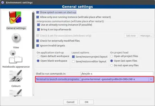

You can use command line options to launch the terminal window with desired settings.
In codeblocks :
  • Go to Settings > Environment > General Settings.
  • Change the "Terminal to launch console programs" option to :
gnome-terminal --geometry=WIDTHxHEIGHT+XOFF+YOFF -x
+XOFF : The left edge of the window is to be placed XOFF pixels in from the left edge of the screen
+YOFF : The top edge of the window is to be YOFF pixels below the top edge of the screen

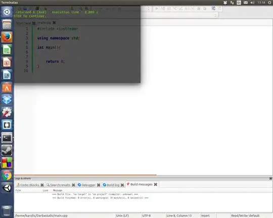

I used the following to have the terminal almost centered on my screen :
gnome-terminal --geometry=80x20+300+240 -x
Dialog in codeblocks and place to launch the terminal with desired settings
