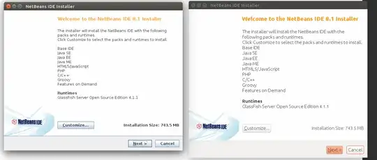

I'm trying to install latest netbeans but installing on normal user results with modern looking gui which freezes after early configuration progress bar.
Running same installer with sudo results in different looking gui which works well, but I don't want to run netbeans on root every time.
This is how it looks: enter image description here
  • Why can't I install netbeans as normal user?
  • What can I do to fix the issue?
