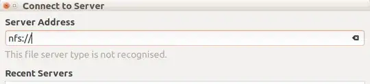

I have an NFS share that I need to connect to (for reasons of speed).
If I try to connect through Nautilus->Connect to Server, I get the error "This file server type is not recognised."
Nautilus Connect to Server NFS attempt showing "This file server type is not recognised."

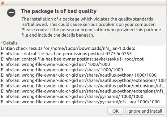

I have looked for a Nautilus plugin and only found nfs-lan, which appears not to have been touched since 2013, and which also appears to fail a number of package checks.
nfs-lan package fails package checks due to bad quality Now, these look minor issues, but it's not a good sign.
