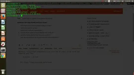

Recently, I installed Anaconda3-2.5.0-Linux-x86_64.sh on my 15.04 and ended up with this!
:~$ python --version
Python 3.5.1 :: Anaconda 2.5.0 (64-bit)
:~$ python2 --version
Python 2.7.9
:~$ python3 --version
During the last moments of installation, I did enter something as yes in hurry, and I suppose it had to do something with this. (Ok, my fault, I should have handled that carefully, but I need help now, not criticism).
Screenshot
AFAIK this is definitely going to break other programs. What do I do now?
