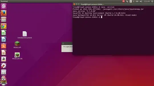

I installed Java 7 and 8 using ppa:webupd8 and my terminal says it is installed, but when trying to run minecraft it says
This application requires a Java Runtime Environment 1.7.0
I'm not the best with Ubuntu and I really can't figure out what the problem is. Any help is appreciated.

  1. By default open-jdk is used in ubuntu, cause for your issue might be not setting up environment variable for java or still ubuntu is using open-jdk.
  2. for that run this command in your terminal sudo update-alternatives --config java
  3. you will get options to select which version of java to use,make sure you select the oracle java 7/8
  4. if that doesn't work start setting up variables as follows:
    sudo -H gedit   /etc/profile
    JAVA_HOME=/usr/lib/jvm/jdk1.7.0
    PATH=$PATH:$HOME/bin:$JAVA_HOME/bin
    export JAVA_HOME
    export JRE_HOME
    export PATH
