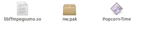

The image below contains all extracted files from .tar: enter image description here
