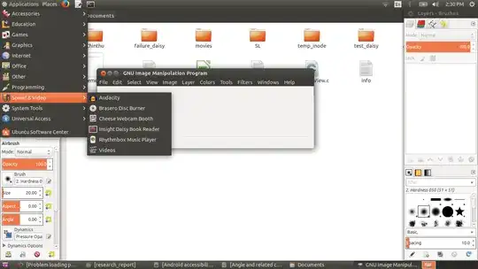

I created a deb file for ubuntu and I can add the program under Sound & Video. But when I try to add icon for it , it show no icon image . My dbr.desktop file content is :
[Desktop Entry]
Encoding=UTF-8
_Name=Insight Daisy Book Reader
_Comment=Read Daisy Talking Books
Exec=dbr
Terminal=false
Type=Application
StartupNotify=true
Categories=GNOME;GTK;AudioVideo;
I put the image icon32x32.png on the same level as this file . The corresponding screenshot shown below (Insight Daisy Book Reader). enter image description here
I am not included the image path not any where in configuration file.
Please advise how to add program icon image ..
Thanks Anes

I suggest you to type the location of your icon completely . Example :
Icon=/usr/share/icons/example.png
You change the word /usr/share/icons with your icon directory.
