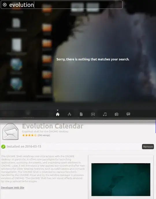

  • Evolution - it does not show in the Lens after being installed:

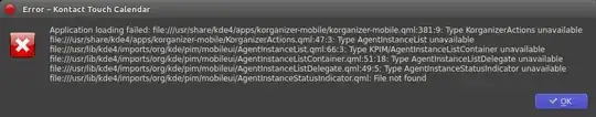

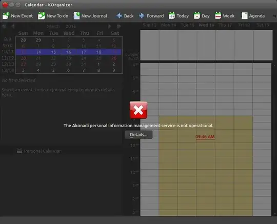

  • KOrganiser - displays an error message; the menus remain active but produce no results.

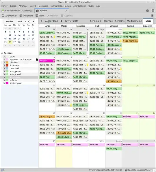

What about the Lighting add-on with Thunderbird? It works well with a NextCloud CalDAV server.
screenshot of the add-on running in thunderbird showing the user's calendar

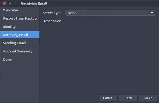

The trickiest bit is the e-mail configuration. You are forced to do so in order to use the calendar (go figure). Install Evolution from the Software Centre and start it up. A configuration menu appears; follow on with all options by default up to the Identify menu.
Enter your name and use the dummy address. If this address is not already there just use something like dummy@mail.com. Uncheck the Look up mail server... box, otherwise the process fails. Click Next.
In the Identity menu, you must choose the None option from the Server Type in order to follow on:

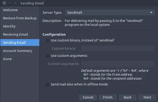

In the Sending Email menu select Sendmail as the Server Type and leave all other boxes empty or unchecked. Click Next on all the following menus to finish the configuration.

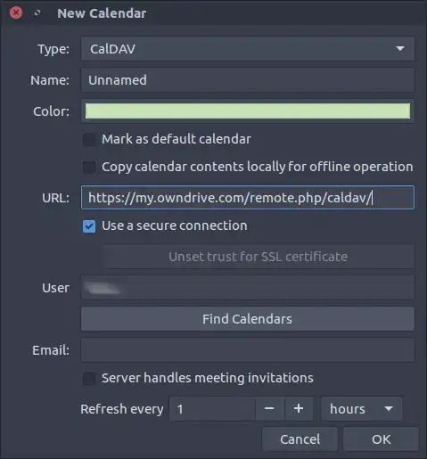

Now you must tell Evolution about your CalDAV service. Go to File > New > Calendar; the New Calendar dialogue appears. In the Type drop down select the CalDAV option. Then insert the URL address of your service, insert something like: https://my.owndrive.com/remote.php/caldav/. This is the URL for OwnDrive, it will be different for other services, you must know the exact address of your CalDAV service. Finally, insert your user name and click the Find Calendars button:
Wait for the remote calendars to be listed (it can take a little while). Select one of the calendars and click OK; click OK again in the New Calendar dialogue and repeat the process for other calendars.

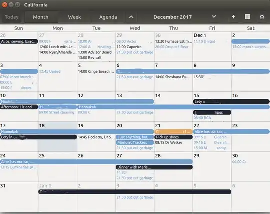

I was experimenting with vdirsync + khal or with California, and have found that California syncs seamlessly with my Nextcloud caldav server. No email account necessary.
I had to add each calendar individually, it couldn't just discover them all via https://example.com/owncloud/remote.php/caldav but once I added each caldav link the calendars did sync.
I will note that it took hours for the first sync to happen, and I don't know what set it off. Then all of a sudden I got a password popup for each calendar and they're now synced. I've tested editing on Nextcloud and locally and the sync seems to be instantaneous.
I'd still like to know how to do this: Can I force calendar sync? but overall I'm pretty happy with it.
NOTE: Calfornia is totally unmaintained and after I filed 2-3 different bug reports someone finally told me that. I like California's week and agenda views, so I use it and Gnome Calendar, which has a sync button.
