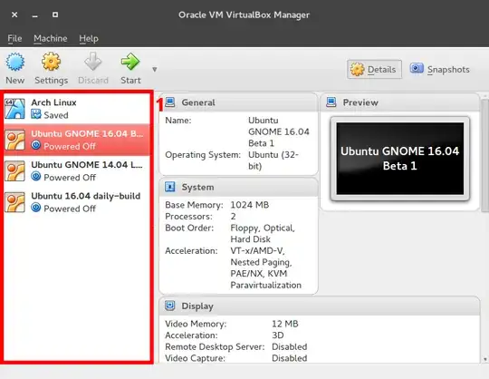

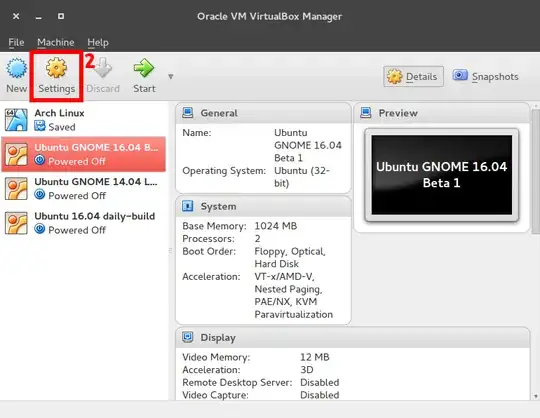

1. Select the VM you want to boot into with the Live Image.
VM Selection
2. Click Settings.
Settings button

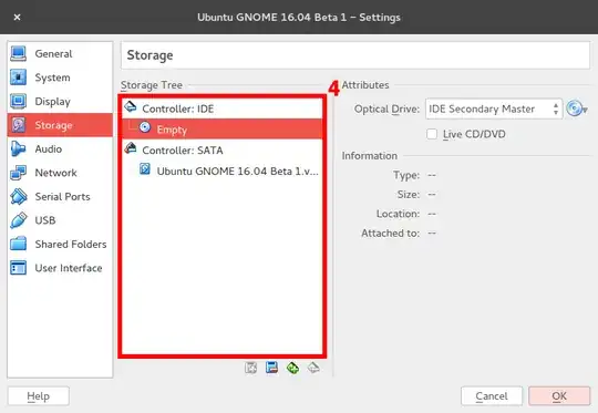

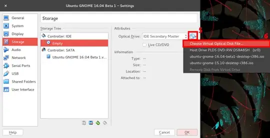

4. In the Storage Tree select the Empty optical disk.
Select <code>Empty</code> optical disk
5. Click the pull-down menu with the image of a disk in the Attributes section.
6. Select the Choose Virtual Optical Disk File... option.
Disk pull-down menu
7. Locate the ISO Live Image you wish to boot from on your system and press OK on any remaining windows. When you now run the VM it should boot into the Live Image.

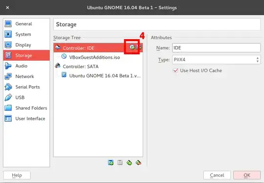

4. Click the Adds optical drive. button.
<code>Adds optical drive.</code> button

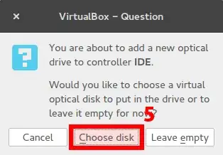

5. Choose the Choose disk option and select the ISO file you wish to boot from.
Choose disk button
6. After doing so press OK and the next time you boot into your VM it will boot into it from the Live Image which you have just selected.

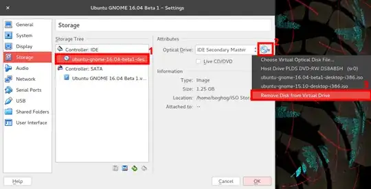

1. Once you are in the Storage section select optical disk which you added.
2. Click the pull-down menu with the image of a disk in the Attributes section.
3. Select the Remove Disk from Virtual Drive option.
Disk pull-down menu and indication of correctly selected optical disk
4. Press OK on any remaining windows and when you next boot into your VM it should boot using its original hard drive.

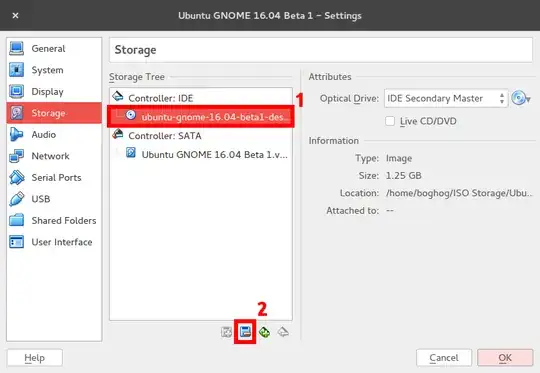

2. Press the Remove selected storage attachment button.
Removing the selected storage attachment
3. Press OK on any remaining windows and when you next boot into your VM it should boot using its original hard drive.

From the GUI:
  1. Select the virtual machine;
  2. Click on Settings;
  3. Click on Storage;
  4. Under Storage Tree you should have at least an optical IDE drive listed under Controller IDE. Select it, click on the CD / DVD icon under Attributes and select Choose Virtual Optical Disk File...
  5. Select the ISO image;
  6. Click on OK;
  7. Boot the VM;
  8. By default the VM will boot into the first optical drive, so as long you don't have other optical drives attached to the VM you should boot directly into the Live DVD; if you have multiple optical drives attached to the VM and you linked the ISO to another optical drive you can override the boot drive at boot time by hitting F12 and selecting the correct drive.
