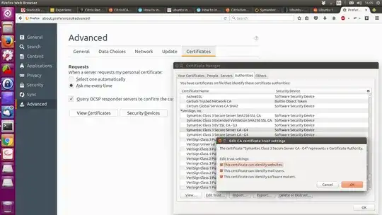

Additionally I checked in Firefox if the certificates are known and even checked all marks (which where not checked before) (Under Settings -> Advanced -> Certificates):
Firefox Certificate settings
