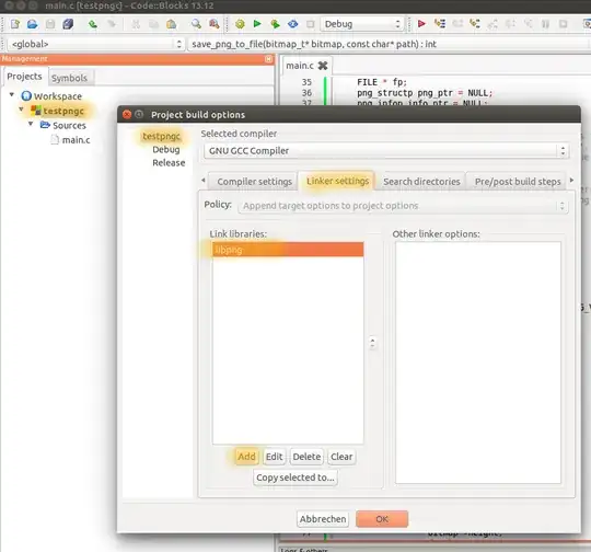

Furthermore, in Code::Blocks right-click on the projectname in the projects-tree, and select "Build options...". In the upcoming window select the top of the tree on the left side (you project name). In the mainpart of the window select "Linker settings". In the left listbox add an entry with the name
libpng
Now your project should compile fine.
