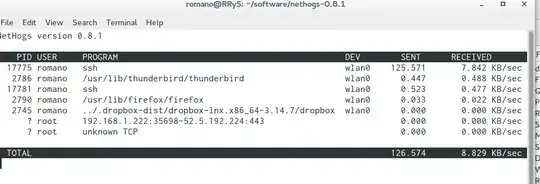

I think that the best tool is nethogs.
Unfortunately, the version available in Ubuntu 14.04 is broken, so you have to compile it yourself: See Nethogs → creating socket failed while establishing local IP - are you root?.
After that, just run:
sudo nethogs wlan0
where wlan0 is the name of the interface you want to monitor.
example of nethogs running
Use q to exit.
