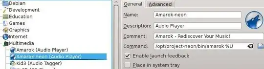

--Edit--
Thoughts after reading the http://developer.ubuntu.com/publish/my-apps-packages/.
"Be able to be installed into /opt/"
just means that the source should run from the /opt/. It does not be in the $PATH, if you are calling it with the full path.
Here the development version of the Amarok is installed under the /opt and the Exec /1/,/2/ key is:
Exec=/opt/project-neon/bin/amarok %U
But this is only my impression !
