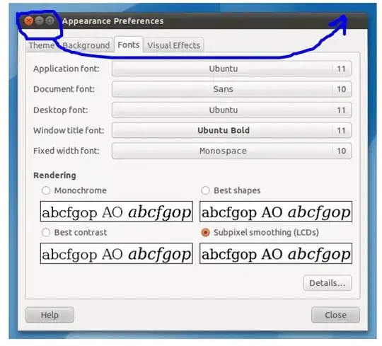

I want to change the location of the 'close' and 'minimize' window. The default location is on upper left - and I want it to be on upper right.
Screenshot attached enter image description here

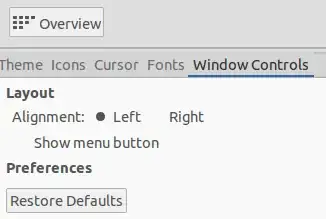

You can do this with unity-tweak-tool
sudo apt-get install unity-tweak-tool
Now go to Appearance > Window Controls and set it to Right
